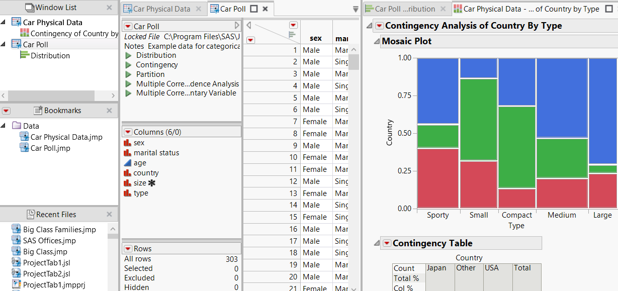

Add and Organize Bookmarks
Bookmarks provide quick access to files that you regularly open.
1. In the Window List, right-click one of the file names and select Bookmark All.
You can also drag the files from the Window List to the Bookmarks pane.
2. To create a group for the data tables, click the Bookmarks red triangle and select New Group. The group organizes the files but does not move them on your computer.
3. Enter Data and click OK.
4. In the Bookmarks pane, select the Car data tables and drag them into the Data group.
Figure 7.4 Bookmarked Files
Rearrange Reports
You can rearrange reports to display them in a separate pane. As you drag the report tab, zones appear that show you where to place, or “dock”, the report.
1. In Car Physical Data.jmp, run the Contingency script.
2. In Car Poll.jmp, run the Distribution script.
The data tables and reports appear in tabs.
Figure 7.5 Tabbed Reports

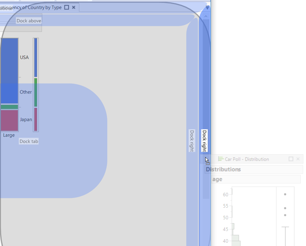

3. Drag the Distribution report tab to the right until the Dock right zone appears on the far right.
Figure 7.6 Dragging a Report
4. Drop the report into the Dock right zone.
The tab appears in a new pane.
Figure 7.7 Report in New Pane

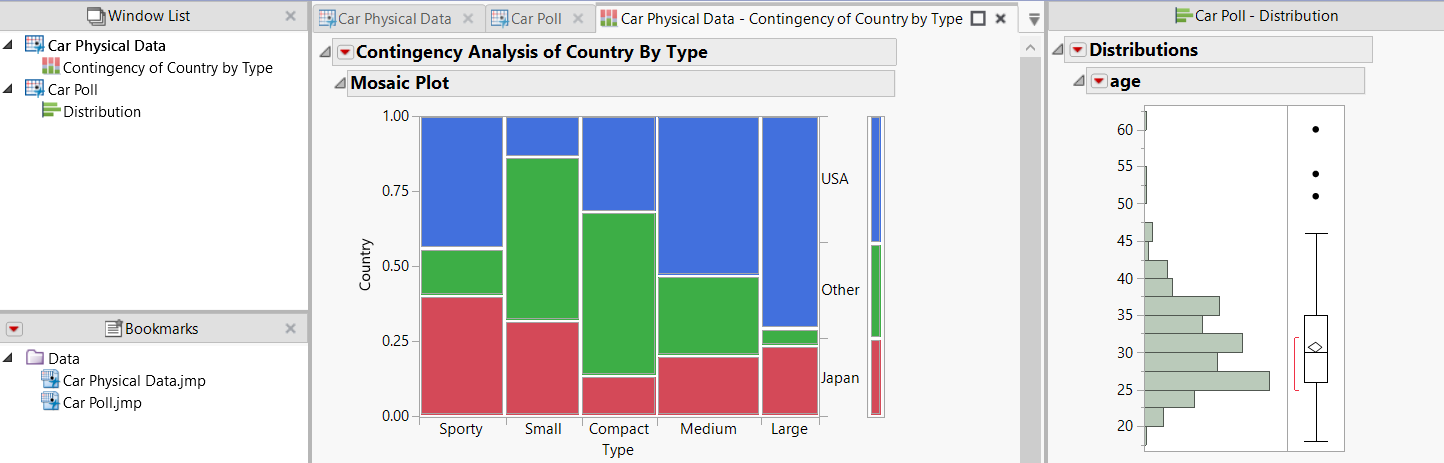

5. Drag the Contingency tab to the middle of the Distribution report.
6. When the Dock tab zone appears, drop the report.
Figure 7.8 Docked Report Tabs
