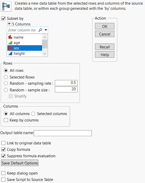

Figure 6.2 The Subset Window
2. Specify the content that you want to subset. Select any combination of the following:
– Subset by (the levels within selected columns)
– Rows (all, selected, or random)
– Columns (all or selected)
In Figure 6.2, the sex column will be subset.
3. Customize your subset table further using the additional options.
4. Click OK to create the subset table.
