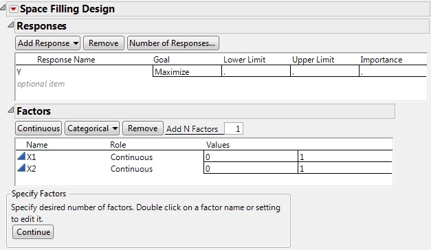

3. Alter the factor level values, if necessary. For example, Figure 21.6 shows the two existing factors, X1 and X2, with values that range from 0 to 1 (instead of the default –1 to 1).
Figure 21.6 Space-Filling Dialog for Two Factors
4. Click Continue.

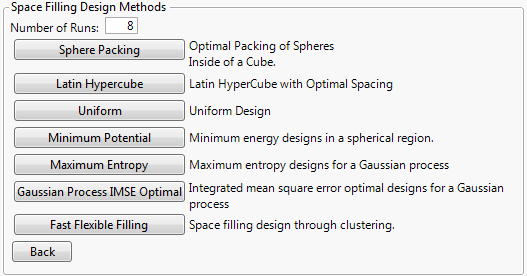

5. In the design specification dialog, specify a sample size (Number of Runs). Figure 21.7 shows a sample size of eight.
Figure 21.7 Space-Filling Design Dialog
6. Click Sphere Packing.
