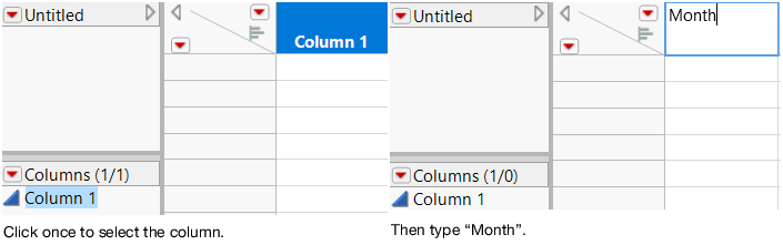

1. Select File > New > Data Table to create an empty data table.
A new data table has one column and no rows.
2. Select the column name and change the name to Month.
Note: To rename a column, you can also double-click the column name or select the column and press Enter.
Figure 3.3 Entering a Column Name

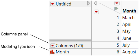

6. Enter the Month information by clicking in a cell and typing.
Figure 3.4 Month Column Completed
In the columns panel, look at the modeling type icon to the left of the column name. It has changed to reflect that Month is now nominal (previously it was continuous). Compare the modeling type shown for Column 1 in Figure 3.3 and for Month in Figure 3.4. This difference is important and is discussed in View or Change Column Information.

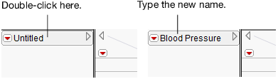

1. Double-click the data table name (Untitled) in the Table Panel.
2. Type the new name (Blood Pressure).
Figure 3.5 Changing the Data Table Name
