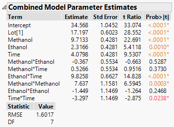

Combined Results
The effects selected for the model are listed in the Combined Model Parameter Estimates report.
Figure 8.4 Combined Model Parameter Estimates Report
The RMSE and degrees of freedom given at the bottom of the report are the usual standard least squares quantities. Use these effects as potential factors for your final model.
