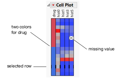

Figure 8.2 Dogs.jmp cell plot
Notice the following:
• There are two types of drugs, represented by two distinct colors.
• Histamine levels are assigned colors from a gradient of blue to red.
• Any missing values are delineated by an X.
• The third row from the bottom is selected, and black lines appear next to the cells.
