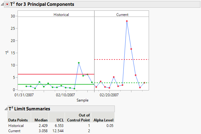

This example demonstrates the use of historical data to set the monitoring limits for current data.

Figure 11.10 T2 Chart for Historical and Current Data
Note that there are two sets of limits. One set applies to the historical data. A second set of limits applies to the current data. For more information about how the historical data is used to calculate the two sets of limits, see Limits. As you add additional observations to the data table, the chart automatically updates.
