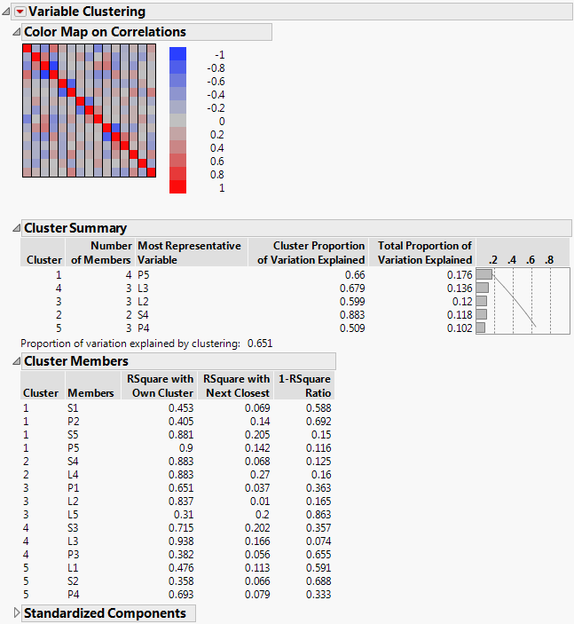

5. Click the Variable Clustering red triangle and select Save Cluster Components.
Five grouped formula columns are added to the data table.
Figure 16.5 Cluster Variables Report for Penta.jmp
The Cluster Summary and Cluster Members reports show that the variables are clustered into five groups, so there are five Cluster Component variables.

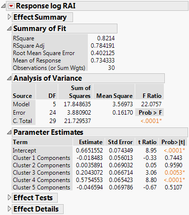

6. In the Fit Model window, select all variables in the Construct Model Effects window and click Remove.
7. Select the Cluster Components group and click Add.
8. Click Run.
Figure 16.7 Fit Least Squares Report for Model with Cluster Components as Predictors
The model that includes the five Cluster Components as the only predictors explains a substantial amount of the variation in the response, with an adjusted RSquare of 0.784. The model that uses all fifteen predictors has only a slightly higher adjusted RSquare of 0.853 (Figure 16.6).
