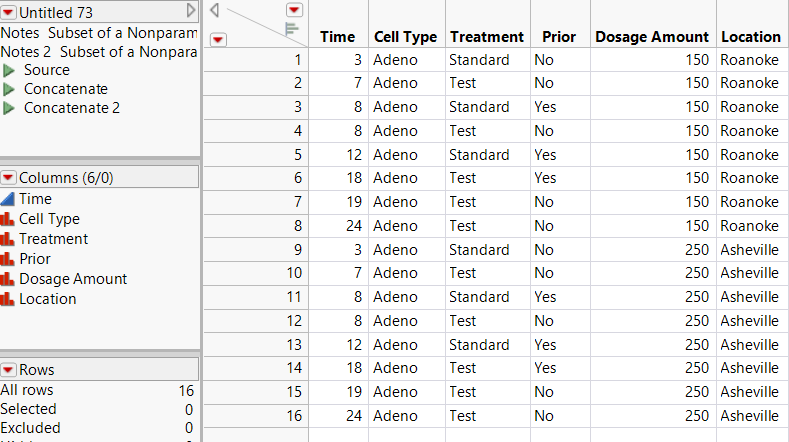

Figure 6.21 Data and Variables Concatenated
The data and the variables are concatenated. The variables appear as columns in the concatenated table. The notes from each data table are added to the new data table as table variables.
