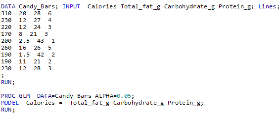

5. Click the Model Specification red triangle and select Create SAS Job.
Figure 8.9 shows the SAS code. (Not all of the data is shown.)
Figure 8.9 SAS CodeĀ
