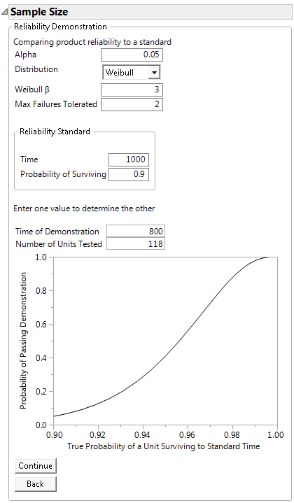

Figure 17.18 Reliability Demonstration Calculator
The company needs to run 118 units in the demonstration. Furthermore, if they observe 2 or fewer failures by 800 hours, they can conclude that the new product reliability is at least as reliable as the standard.
The plot shows that as the true probability of a unit surviving to the time in the reliability standard increases, the probability of passing the demonstration increases. In this example, if a unit has only a 92% chance of surviving to the standard time, then the chance of the new product passing the demonstration is only about 12.5%.
