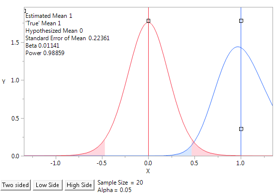

Figure 17.1 Power Animation for One Sample Mean
