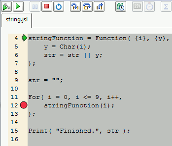

1. Open the string.jsl sample script and click the Debug Script button.
2. Click in the margin for line 12 to add a breakpoint.
You should have a breakpoint for the following expression inside the For() loop:
stringFunction(i);
Figure 4.11 Set the Breakpoint

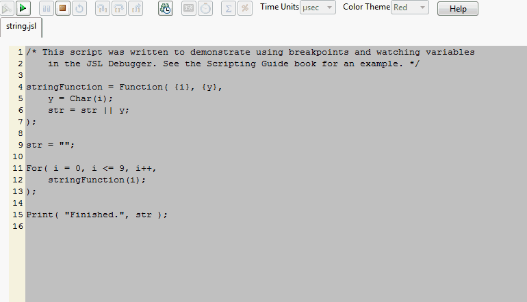

1. Open the string.jsl sample script.
2. Click the Debug Script button .
3. Click the Profile JSL Script button .
Figure 4.15 Initial JSL Profiler Window
4. Click the Run button to start profiling.

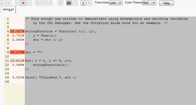

The profiler collects information on the number of times a statement is executed and the time it takes to execute it. Time is cumulative and collected each time a JSL statement is executed.
Figure 4.16 Profiled Script Window
In the left margin, the selected statistics are displayed. Percent of time is displayed by default. Click the Show Profile by Count button to switch to percent of statement counts instead. The left margin is color-coded to allow for quick identification of problematic performance areas.
