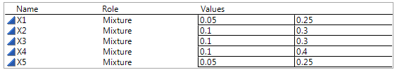

2. Under Factors, enter 2 for the number of additional factors to add and click Add.
3. Set the ranges for the five factors as shown in Figure 13.12 and click Continue.

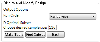

The default number of runs for this five-factor, degree 4 extreme vertices design is 116. This is the number of extreme vertices and averages up to degree 4 for these five factors given the constraints on their ranges. JMP uses the default set of mixtures as a candidate set to generate a smaller D Optimal design.
5. (Optional) To match the output of this example, click the Mixture Design red triangle and select Set Random Seed, and then enter 1409.

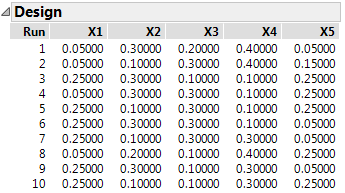

6. Enter 10 in the Choose desired sample size box and click Find Subset to generate the design.
Note: The Find Subset option uses the row exchange method (not coordinate exchange) to find the optimal subset of rows.
Figure 13.14 Ten Run D-optimal Extreme Vertices Design

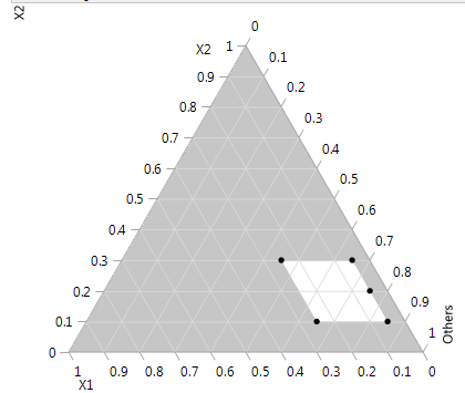

Visualize the Design
8. From the design table, select Graph >Ternary Plot.
9. Select X1, X2, X3, X4, and X5 and click X, Plotting, and then click OK.
Figure 13.15 Partial Output of Ternary Plot for Five-Factor Design
When you have more than three mixture components, the ternary plot shows a series of plots. Each plot has two component axes and the third axis is the sum of all other components. The plots are shaded if you have a constrained region. The unshaded portion represents the feasible region. For more information about ternary plots, see Ternary Plot Overview.

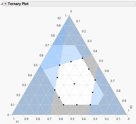

6. From the design table, select Graph >Ternary Plot.
7. Select X1, X2, and X3 and click X, Plotting, and then click OK.
Figure 13.17 Ternary Plot Showing Piepel Example with Constraints
The ternary plot shows the feasible region as defined by the factor limits and the linear constraints. The design points are at the six vertices of the feasible region, at the six edge mid-points, and the overall centroid. For more information about ternary plots, see Ternary Plot Overview.
