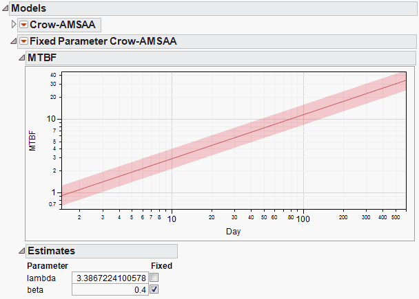

This option enables you to specify parameter values for a Crow-AMSAA fit. If a Crow-AMSAA report has not been obtained before choosing the Fixed Parameter Crow-AMSAA option, then both a Crow-AMSAA report and a Fixed Parameter Crow-AMSAA report are provided.
When the Fixed Parameter Crow-AMSAA option is selected, the Cumulative Events Plot updates to display this model. The Model List also updates. The Fixed Parameter Crow-AMSAA report opens to show the MTBF plot for the Crow-AMSAA fit; this plot is described in the section MTBF Plot.

The initial parameter estimates are the MLEs from the Crow-ASMAA fit. Either parameter can be fixed by checking the box next to the desired parameter and then entering the desired value. The model is re-estimated and the MTBF plot updates to describe this model. Figure 10.16 shows a fixed-parameter Crow-AMSAA fit to the data in TurbineEngineDesign1.jmp, with the value of beta set at 0.4.
Figure 10.16 Fixed Parameter Crow AMSAA ReportĀ
