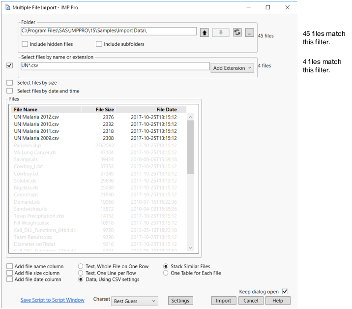

2. Select File > Import Multiple Files (Windows) or File > Open Multiple (Mac).
3. Browse to select the JMP Samples/Import Data folder.
4. In the Select Files by name or extension box, type UN*.csv and press Enter.
In this example, the files have the UN prefix and are CSV files.
The Files list updates to show which files have been selected.
Specify multiple file names and extensions by separating them with semicolons, or click Add Extension and select an extension.
Figure 3.18 Selected CSV Files
Notice that the Refresh button flashes if the files have changed in the directory since the last refresh.

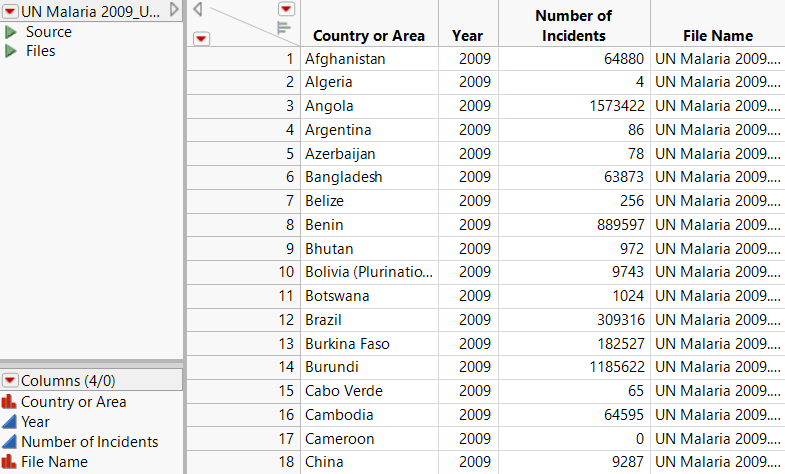

6. Keep Stack Similar Files selected because these CSV files have the same columns.
7. Click Import.
JMP applies the file name, file size, and file date and time filters to stack the files. Data with columns that contain the same column headings are imported in the same data table. If the columns do not match, the mismatched columns are imported into a separate data table.
