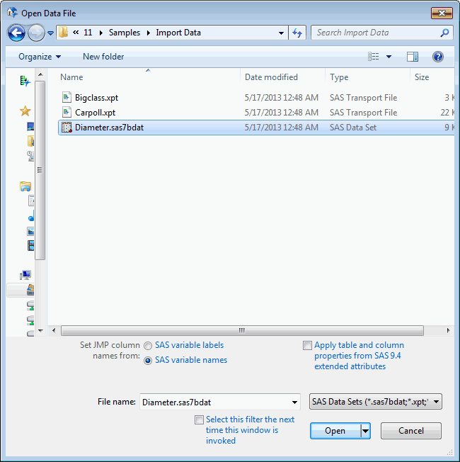

1. Select File > Open.
2. (Windows only) Select SAS Data Sets from the list next to File name as shown in Figure 3.49.
Note: SAS variable names and formats are preserved and can be saved after changes are made to the SAS data set. See Deselect Display intranet sites in Compatibility View.Save as a SAS Data Set in the Save and Share Data section.
3. Select the file.
Figure 3.49 Open SAS Data Set
Note: To select the columns to import, click the arrow on the Open button and select Select columns.
