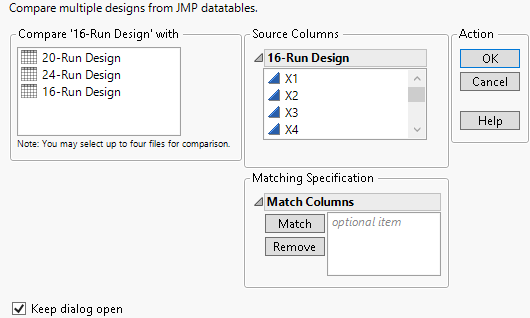

Launch the Compare Designs platform by selecting DOE > Design Diagnostics > Compare Designs. All open data tables appear in the list at the left. The active data table and its columns appear in a Source Columns panel. The design in the initial Source Columns panel is the reference design, namely, the design to which other designs are compared. When you add designs to compare to the reference design, their columns appear in panels under the reference design panel.
Figure 16.17 shows the launch window for the three designs in Designs of Different Run Sizes.
Figure 16.17 Compare Designs Launch Window

Select up to four design tables from the list on the left.
• To compare multiple designs to the reference design, you must select their design tables simultaneously from the list on the left.
• To replace a design (or designs) in the Source Columns list, select the desired table (or tables) from the list at the left. The design table (or tables) under the reference design table are replaced.
Note: The reference design table can be compared to itself, which can be useful when exploring the assignment of design columns to factors.
