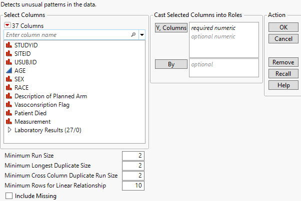

Launch the Explore Patterns Utility
Launch the Explore Patterns utility by selecting Analyze > Screening > Explore Patterns.
Figure 20.17 Explore Patterns Utility Launch Window
Y, Columns
Assigns the columns to analyze. The variables must be numeric and continuous.
By
Assigns one or more columns whose levels define separate analyses. For each level of the specified column, the corresponding rows are analyzed using the other variables that you have specified. The results are presented in separate reports. If more than one By variable is assigned, a separate report is produced for each possible combination of the levels of the By variables.
Minimum Run Size
Specifies the minimum number of values in a row for a sequence to be reported as a run.
Minimum Longest Duplicate Size
Specifies the minimum length of a sequence for it to be reported as a duplicate sequence within a column.
Minimum Cross Column Duplicate Run Size
Specifies the minimum length of a sequence for it to be reported as a duplicate sequence across columns.
Minimum Rows for Linear Relationship
Specifies the minimum number of rows used for detecting linear relationships between columns across groups of rows.
Note: The minimum number of rows must be greater than or equal to three.
Include Missing
Specifies that missing values be included in pattern detection.
