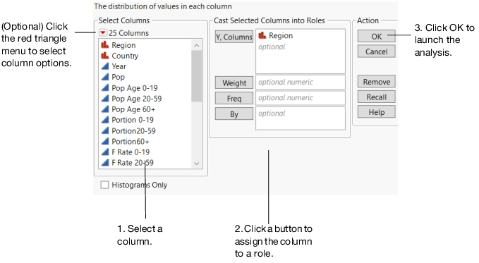

The launch window is your point of entry into a platform, where you specify the columns to analyze. Figure 2.11 shows the Distribution launch window.
Figure 2.11 Launch Window Features
All launch windows have in common provide the following options:
Select Columns
Lists all of the variables in your current data table. Note the following:
– Right-click the modeling type icon next to a column name to change the modeling type.
– Right-click the column name to create a transform column. See Transform Columns in the Enter and Edit Data section.
– Filter and sort the columns using the options in the red triangle menu. See Column Filter Menu.
Cast Selected Columns into Roles
Moves selected columns into roles (such as Y, X, and so on.) You cast a column into the role of a variable (like an actor is cast into a role). See Cast Selected Columns into Roles Buttons.
