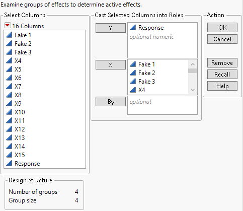

Launch the Fit Group Orthogonal Supersaturated Design platform by selecting DOE > Special Purpose > Group Orthogonal Supersaturated > Fit Group Orthogonal Supersaturated.
Note: If you created your design in JMP using the Group Orthogonal Supersaturated platform, the design table contains a script called Model. Run this script to run the analysis directly.
Figure 26.4 Fit Group Orthogonal Supersaturated Launch Window
Y
One or more numeric response variables.
X
Two-level continuous or categorical factors. Because the platform uses the unique structure of a GOSSD in performing the analysis, these factors must define a GOSSD.
