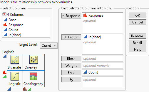

To perform a logistic analysis, do the following:
1. Select Analyze > Fit Y by X.
2. Enter a nominal or ordinal column for Y, Response.
3. Enter a continuous column for X, Factor.
Figure 8.3 Fit Y by X Launch Window
The word Logistic appears above the image, to indicate that you are performing a logistic analysis.
Note: You can also launch a logistic analysis from the JMP Starter window. Select View > JMP Starter > Basic > Logistic.
When the response is binary and has a nominal modeling type, a Target Level menu appears in the launch window. Use this menu to specify the level of the response whose probability you want to model.
For more information about the Fit Y by X launch window, see Introduction to Fit Y by X. For more information about the options in the Select Columns red triangle menu, see Column Filter Menu in Using JMP.
