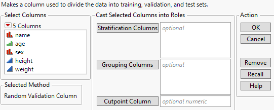

Launch the Make Validation Column platform by selecting Analyze > Predictive Modeling > Make Validation Column.
Figure 11.3 Make Validation Column Launch Window
The Make Validation Column launch window provides the following options:

Selected Method
Describes the selected validation column method based on the specified stratification, grouping, and cutpoint columns. After a method is selected and you click OK, you specify the allocations for each set in the Make Validation Column report. See Specify Rates or Relative Rates and Set Cutpoints. There are five methods for constructing the holdback sets:
