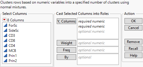

Launch the Normal Mixtures Clustering platform by selecting Analyze > Clustering > Normal Mixtures.
Figure 14.4 Normal Mixtures Launch Window
Y, Columns
The variables used for clustering observations.
Note: Normal Mixtures clustering supports only numeric columns.
Weight
A column whose numeric values assign a weight to each row in the analysis.
Freq
A column whose numeric values assign a frequency to each row in the analysis.
By
A column whose levels define separate analyses. For each level of the specified column, the corresponding rows are analyzed. The results are presented in separate reports. If more than one By variable is assigned, a separate analysis is produced for each possible combination of the levels of the By variables.
