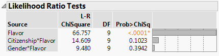

Figure 5.17 shows the Likelihood Ratio Tests report obtained by running the script MaxDiff for Flavor in Potato Chip Responses.jmp.
Figure 5.17 Likelihood Ratio TestsĀ
Source
Lists the effects in the model.
L-R ChiSquare
The value of the likelihood ratio ChiSquare statistic for a test of the corresponding effect.
DF
The degrees of freedom for the ChiSquare test.
Prob>ChiSq
The p-value for the ChiSquare test.
Bar Chart
Shows a bar chart of the L-R ChiSquare values.
