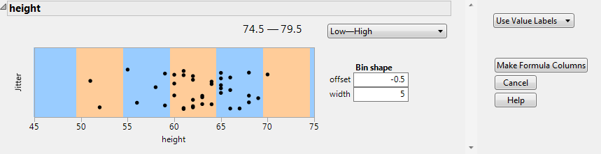

Example of Making a Binning Formula
1. Select Help > Sample Data Library and open Big Class.jmp.
2. Select the height column.
3. Select Cols > Utilities > Make Binning Formula.
You want the range of values to appear as X-X, so keep the range set to Low - High.
4. Change the offset to -0.5.
Tip: For integer data, setting the offset to -0.5 helps disambiguate values on the edge. In this example, one of the bins covers 59.5 to 64.5, so it is clear that 59 and 65 are not included in this bin.
5. Keep the width set to 5.
6. For the labels, keep it set to Use Value Labels, so that you can see the range of values for the bin.
Figure 4.36 Completed Binning Window
7. Click Make Formula Columns.
