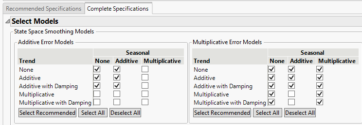

Select Models
Available only in the Complete Specifications tab, shown in Complete Specifications Tab. The Select Models report enables you to specify the state space smoothing models to fit to the individual time series. Use the check boxes to select the error, trend, and seasonality for the models. Click Select Recommended to select the check boxes that correspond to the models recommended by the platform. Click Select All to select all check boxes or Deselect All to deselect all check boxes.
Figure 18.5 Complete Specifications Tab
