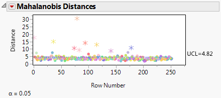

Figure 20.8 Multivariate Robust Outliers Mahalanobis Distance Plot
Figure 20.8 shows the Mahalanobis distances of 16 different columns. The plot contains an upper control limit (UCL) of 4.82.This UCL is meant to be a helpful guide to show where potential outliers might be. However, you should use your own discretion to determine which values are outliers. For more information about this upper control limit (UCL), see Mason and Young (2002).
