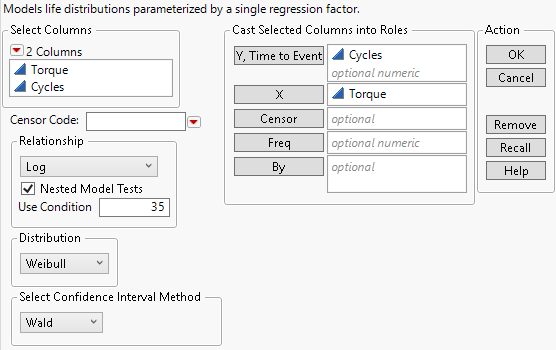

1. Select Help > Sample Data Library and open Design Experiment/Torque Prior.jmp.
2. Select Analyze > Reliability and Survival > Fit Life by X.
3. Select Cycles and click Y, Time to Event.
4. Select Torque and click X.
5. From the Relationship list, select Log.
6. Enter 35 for the Use Condition.
7. From the Distribution list, select Weibull.
Figure 22.2 Fit Life by X Launch Window
8. Click OK.

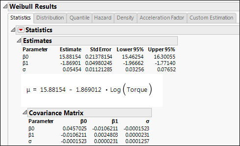

9. Scroll down to the Weibull Results outline and open the Covariance Matrix outline.
Figure 22.3 Fit Life by X Model for Prior Data
The model for the mean is given in the Estimates outline. The Estimate column contains the parameter estimates for the intercept (β0), the linear coefficient (β1), and the scale (σ). The estimated variances and covariances for the parameter estimates are given in the Covariance Matrix outline. Use these parameter estimates and their covariances as your prior values when you construct your ALT design.
