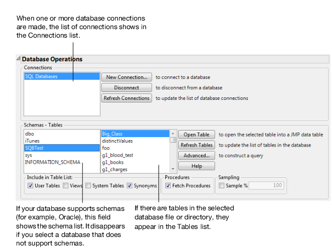

1. Select File > Database > Open Table.
The Database Open Table window appears (Figure 3.66).
2. If you are already connected to the database, select it in the Connections box. Follow the steps in Connect to a Database.
The Connections box lists data sources to which JMP is connected. The Schemas - Tables box lists schemas for those databases that support them.
Figure 3.66 Database Open Table Window
Note: The Fetch Procedures check box is disabled if the ODBC driver does not support fetching procedures.
3. If the desired data source is not listed in the Connections box, click New Connection to choose a data source. The method of choosing a data source depends on your operating system.
4. Select the desired data source in the Connections box. The tables list in the Tables box updates accordingly. The update might take a several seconds, depending on the number of tables and the speed of the connection to the database. If your database supports schemas, tables are loaded for the first schema in the list, and on other schemas as you click them.

6. Select the desired table from the Tables list.
Note: If you are connected to a dBase database, select the database folder to which you would like to connect. Individual files are grayed out and cannot be selected.
7. Click Open Table to import all the data in the selected table, or click Advanced to specify a subset of the table to be imported. Some databases require that you enter the user ID and password to access the data.
