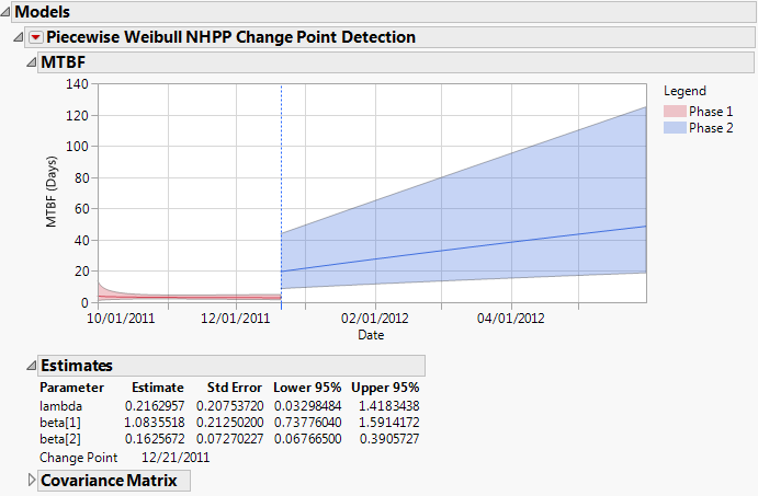

The Piecewise Weibull NHPP Change Point Detection option attempts to find a time point where the reliability model changes. This might be useful if you suspect that a change in reliability growth has occurred over the testing period. Note that detection seeks only a single change point, corresponding to two potential phases.

When the Piecewise Weibull NHPP Change Point Detection option is selected, the estimated model plot and confidence bands are added to the Cumulative Events report under Observed Data. The Model List updates, giving statistics that are conditioned on the estimated change point. Under Models, a Piecewise Weibull NHPP Change Point Detection report is provided.
The default Piecewise Weibull NHPP Change Point Detection report shows the MTBF plot, Estimates, and Covariance Matrix. (See Figure 10.22, which uses the data in BrakeReliability.jmp, found in the Reliability subfolder.) Note that the Change Point, shown at the bottom of the Estimates report, is estimated as 12/21/2011. The standard errors and confidence intervals consider the change point to be known. The plot and the Estimates report are described in the section Piecewise Weibull NHPP.
Figure 10.22 Piecewise Weibull NHPP Change Point Detection Report
