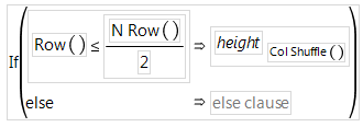

Col Shuffle
Selects a row number at random from the current data table. Each row number is selected only once. When Col Shuffle is used as a subscript, it returns a value selected at random from the column that serves as its argument. Each value from the original column is assigned only once as Col Shuffle’s result.
For example, to identify a 50% random sample without replacement, use the formula in Figure A.16.
Figure A.16 Formula Identifying 50% Random Sample
The formula in Figure A.16 selects half the values (n/2) from the column x and assigns them to the first half of the rows in the computed column. The remaining rows of the computed column fill with missing values.
