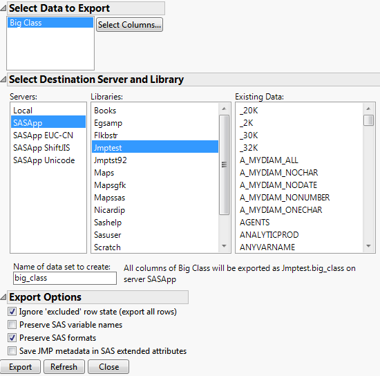

4. Select the data table that you want to export to SAS from the list of open data tables under Select Data to Export.
Figure 3.64 Export Data to SAS
5. (Optional) To export only some of the columns in the data table, click Select Columns. See To select columns to export.
6. Select the Destination Server.
7. Select the Library.
Tip: If your libraries do not appear, see Show Libraries in the Export Data to SAS Window.
A list of the data sets in the library appears.
8. Enter the name as you want it to appear in the SAS library.
9. (Optional) Set the export options that you want to use. See Export Options.
10. Click Export.
