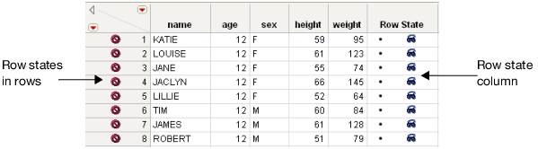

Similar to assigning row states to rows, you can create a column that contains only row state information. A row state column stores information about whether rows are excluded, hidden, labeled, colored, marked, or selected. To designate a column as a row state column, in the Column Info window next to Data Type, select Row State.
Figure 5.4 Row States in Rows and a Row State Column
Since row state columns store the row states, you can apply them again later. Populate row state columns by copying them from the current row states or with column formulas.
