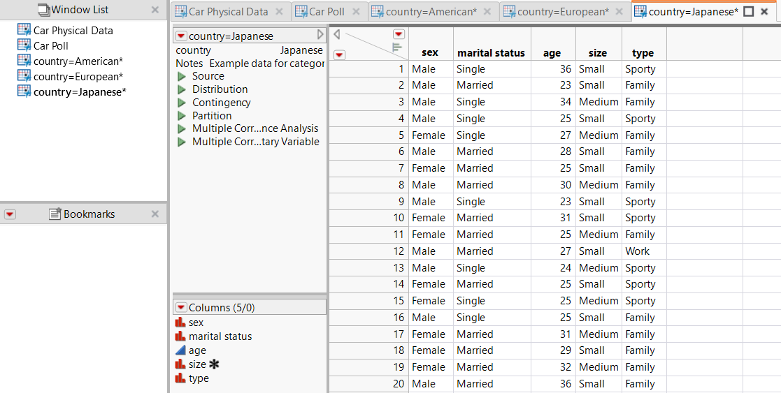

Three new data tables subset by country are created in the project. Notice the asterisk on the tab of each new data table.
Figure 10.20 New Subset Data TablesĀ
6. Select each new tab, select File > Save, and save the file on your computer.

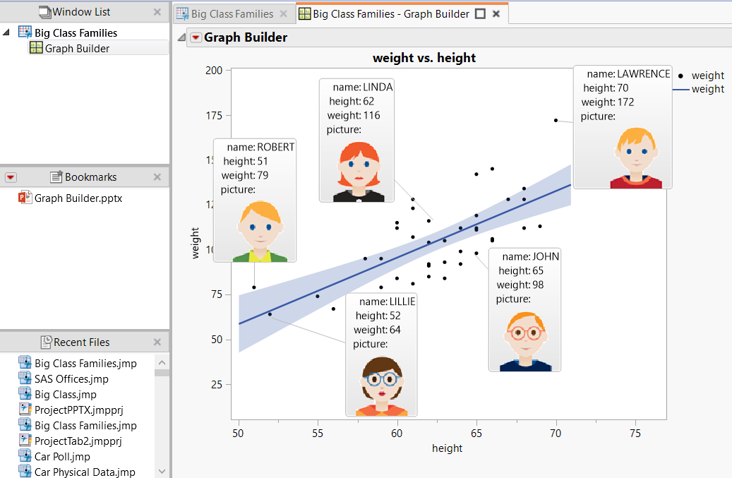

6. In JMP, click the Bookmarks red triangle, select Add Files, navigate to the Graph Builder.pptx file that you created, and then Choose.
The PPTX file is added to the Bookmarks pane.
