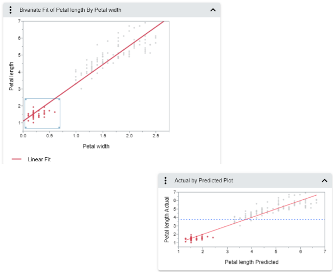

• Explore interactive graph features, such as selecting histogram bars and viewing data values.
• View data by brushing.
• Show or hide report sections.
• Place your cursor over the report for tooltips.
• Increase the marker size.
Figure 7.15 Brushing Data in Interactive HTML
