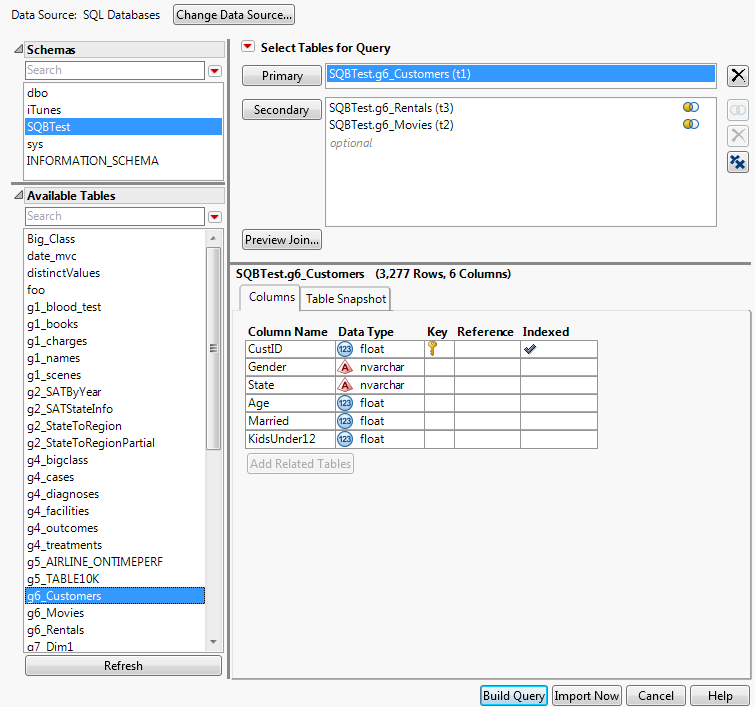

1. Select File > New > Database Query, connect to the database, and select the SQBTest schema. See Connect to a Database.
2. Select the schema from the Schemas - Tables list.
If you also select a table, that table will be the primary table after you click Next.
3. In the Select Tables for Query window, select g6_Customers from the Available Tables list, and then click Primary.
The Columns tab shows that CustID is the primary key. The data is indexed, which speeds up the query.
4. Select g6_Movies and g6_Rentals from the Available Tables list, and then click Secondary.
The Left Join icon indicates that the tables were automatically joined (Figure 3.35). CustID is the primary key in g6_Customers and matches a foreign key in one of the other tables.
Tip: After you add a primary or secondary table, click Add Related Tables to add tables that have matching columns. The button is unavailable when no related tables are found or when a primary or secondary table is not selected.
Figure 3.35 shows the completed window.
Figure 3.35 Selecting Primary and Secondary Tables

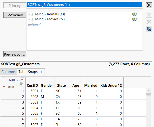

5. Click the Table Snapshot tab for each table to preview the data.
Figure 3.36 Table Snapshot Tab

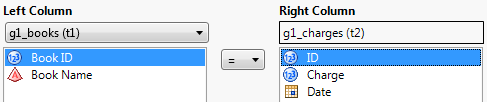

3. Select g1_charges in the Secondary table pane and click Edit Join .
The Add Condition window appears.
4. In the Left Column list, select g1_books.
5. Select Book ID from the Left Column box.
6. Select ID from the Right Column box.
7. Make sure that the equal sign is selected between the two boxes.
Figure 3.37 The Add Condition Window
