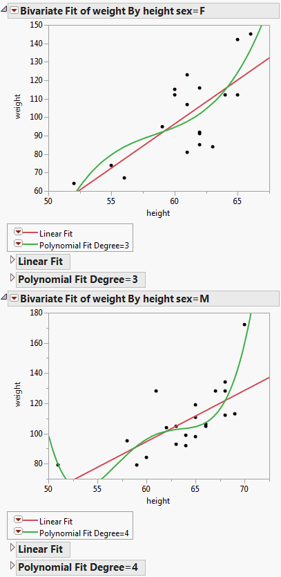

4. Send a message to all By levels to add a linear regression fit. Add this line to the script:
biv << Fit Line;
5. Highlight the line you just created and click Run Script .
In the report window, a linear regression line is added to both graphs, with the corresponding Linear Fit reports.
6. Send a message to only the F level, adding a cubic polynomial fit. Add this line to the script:
biv[1] << Fit Polynomial( 3 );
Tip: The number for each By level corresponds to their order in the report window, which is usually alphanumeric. If the By column contains a Value Order column property, that ordering is followed.
7. Highlight the line you just created and click Run Script .
In the report window, a polynomial fit line is added to the F graph, with the corresponding Polynomial Fit reports.
8. Send a message only to the M level, adding a quartic polynomial fit. Add this line to the script:
biv[2] << Fit Polynomial( 4 );
9. Highlight the line you just created and click Run Script .
In the report window, a quartic fit line is added to the M graph, with the corresponding Polynomial Fit reports.
Figure 10.2 By Group ReportsĀ
