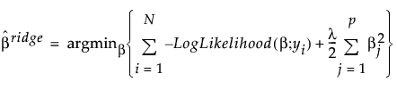

Ridge Regression
An l2 penalty is applied to the regression coefficients during ridge regression. Ridge regression coefficient estimates are given by the following:
where is the l2 penalty, λ is the tuning parameter, N is the number of rows, and p is the number of variables.

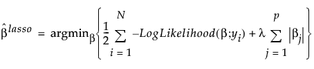

Lasso Regression
An l1 penalty is applied to the regression coefficients during Lasso. Coefficient estimates for the Lasso are given by the following:
where is the l1 penalty, λ is the tuning parameter, N is the number of rows, and p is the number of variables

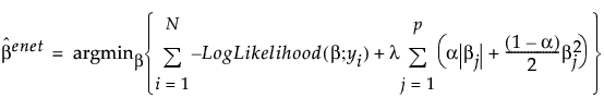

Elastic Net
The Elastic Net combines both l1 and l2 penalties. Coefficient estimates for the Elastic Net are given by the following:
The notation used in this equation is as follows:
• is the l1 penalty
• is the l2 penalty
• λ is the tuning parameter
• α is a parameter that determines the mix of the l1 and l2 penalties
• N is the number of rows
• p is the number of variables
