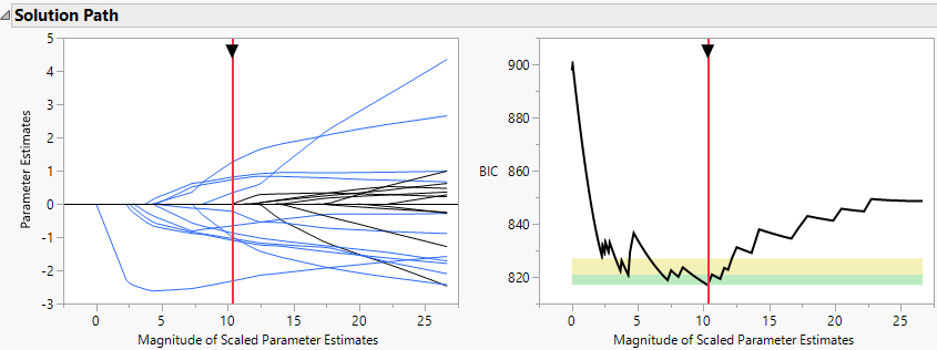

Figure 6.1 The Solution Path for an Elastic Net FitÂ
