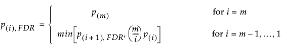

The p-values adjusted for the false discovery rate, denoted p(i), FDR, are computed as follows:
If a hypothesis has an FDR-adjusted p-value that falls below α, then it is rejected by the procedure.
