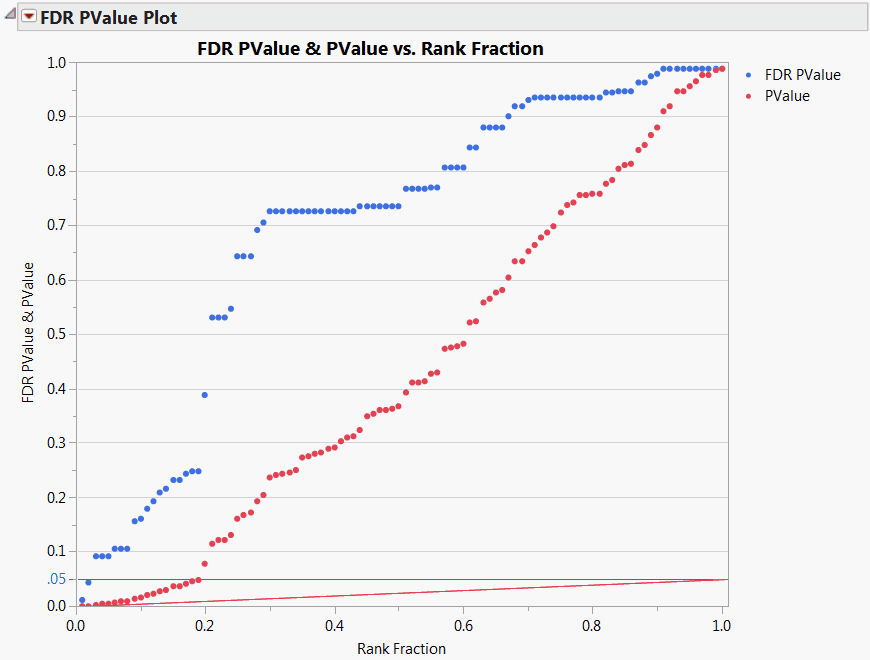

Response Screening automates the process of conducting tests across a large number of responses. Your test results and summary statistics are presented in data tables, rather than reports, to enable data exploration. A False-Discovery Rate approach guards against incorrect declarations of significance. Plots of p-values are scaled using the LogWorth, making them easily interpretable.
