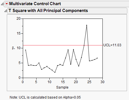

Figure 10.2 Initial Multivariate Control Chart
The process seems to be in reasonable statistical control, because there is only one out-of-control point. Therefore, it is appropriate to create targets based on this data.

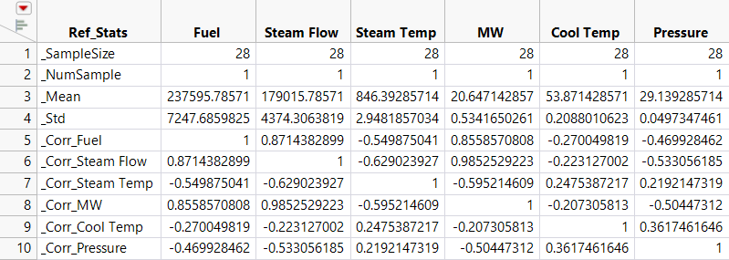

This creates a new data table containing target statistics for the process.
Figure 10.3 Target Statistics for Steam Turbine Data
2. Save the new data table as Steam Turbine Targets.jmp.

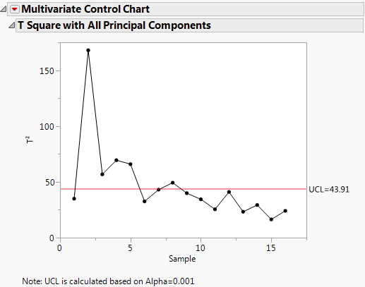

The default alpha level is set to 0.05. Change it to 0.001.
7. Click the red triangle next to Multivariate Control Chart and select Set Alpha Level > Other.
8. Type 0.001 and click OK.
Figure 10.4 Steam Turbine Control Chart
Figure 10.4 shows out-of-control conditions occurring at observations 2, 3, 4, 5, and 8. This result implies that these observations do not conform to the historical data from Steam Turbine Historical.jmp, and that the process should be further investigated. To find an assignable cause, you might want to examine individual univariate control charts or perform another univariate procedure.
