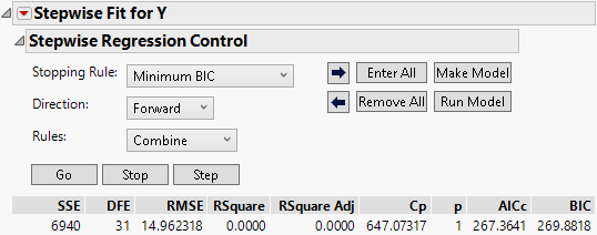

Stepwise Regression Control Panel
Use the Stepwise Regression Control panel to limit regressor effect probabilities, determine the method of selecting effects, begin or stop the selection process, and run a model. A note appears beneath the Go button to indicate whether you have excluded or missing rows.
Figure 5.3 Stepwise Regression Control Panel

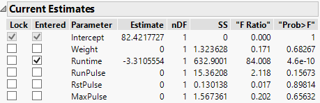

Forward Selection Example
In forward selection, terms are entered into the model and most significant terms are added until all of the terms are significant.
1. Complete the steps in Example Using Stepwise Regression.
Notice that the default selection for Direction is Forward.
2. Click Step.
In Figure 5.4, you can see that after one step, the most significant term, Runtime, is entered into the model.

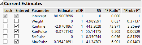

3. Click Go.
In Figure 5.5 you can see that all of the terms have been added, except RstPulse and Weight.
Figure 5.4 Current Estimates Table for Forward Selection after One Step
Figure 5.5 Current Estimates Table for Forward Selection after Three Steps

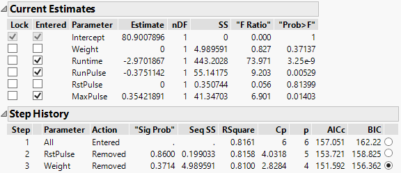

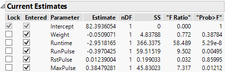

Backward Selection Example
In backward selection, all terms are entered into the model and then the least significant terms are removed until all of the remaining terms are significant.
2. Click Enter All.
Figure 5.6 All Effects Entered into the Model
3. For Direction, select Backward.
4. Click Step two times.
The first backward step removes RstPulse and the second backward step removes Weight.
Figure 5.7 Current Estimates with Terms Removed and Step History Table
The Current Estimates and Step History tables shown in Figure 5.7 summarize the backward stepwise selection process. Note the BIC value of 156.362 for the third step in the Step History table. If you click Step again to remove another parameter from the model, the BIC value increases to 159.984. For this reason, you choose the step 3 model. This is also the model that the Go button produces.
