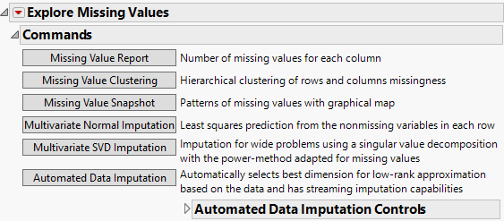

After you click OK in the launch window, the report opens to show a Commands outline and a Missing Columns report. The commands are the following:
• Missing Value Report
• Missing Value Clustering
• Missing Value Snapshot
• Multivariate Normal Imputation (Not available if you entered a Numeric column with a Nominal or Ordinal modeling type in the launch window.)
• Multivariate SVD Imputation (Not available if you entered a Numeric column with a Nominal or Ordinal modeling type in the launch window.)
• Automated Data Imputation (Not available if you entered a Numeric column with a Nominal or Ordinal modeling type in the launch window.)

Figure 20.14 ADI Controls
