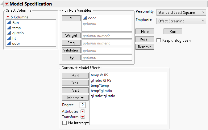

In the Odor Control Original.jmp sample data table, you want to fit a response surface to model the response, odor, as a function of temp and gl ratio. (Although you could include ht, as shown in the data table script Response Surface, for this illustration do not.)
1. Select Help > Sample Data Library and open Odor Control Original.jmp.
3. In the Select Columns list, select odor and click Y.
4. In the Select Columns list, select temp and gl ratio.
5. Select Macros > Response Surface.
Figure 2.20 Fit Model Window for Two-Factor Response Surface ModelĀ
6. Click Run.

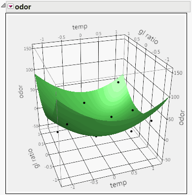

Figure 2.21 shows a Surface Profiler plot of the data and a quadratic response surface fit to the data for the Odor Control Original.jmp sample data table. To obtain this plot, click the Response odor red triangle and select Factor Profiling > Surface Profiler. To show the points, click the disclosure icon to open the Appearance panel and click Actual. If you want to make the points appear larger, right-click in the plot, select Settings and adjust the Marker Size.
Figure 2.21 Model Fit for a Degree-Two Polynomial in Two VariablesĀ
