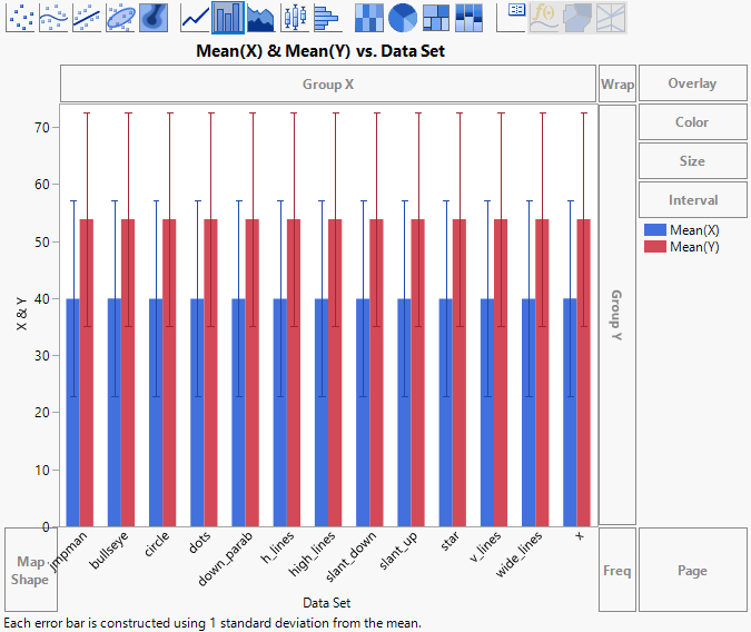

1. Select Help > Sample Data Library and open JMP Man Dozen.jmp.
3. Select X and Y and drag them to the Y zone.
4. Select Data Set and drag it to the X zone.
5. Click the Bar element .
6. For the Error Interval, select Standard Deviation.
Figure 9.41 Original Graph for JMP Man Dozen.jmp
You can see that the mean and standard deviation for these observations are the same, so this graph does not tell you much. Use preset graphs to get more insight into the data.

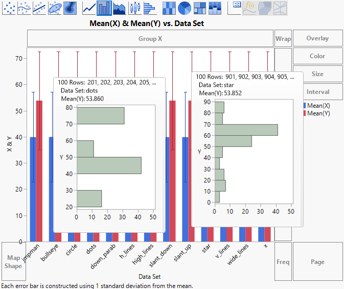

1. In the graph, right-click and select Hover Label > Histogram.
This adds preset histograms to the hover labels.
2. Point to some of the bars. For example, point to the red bars for dots and star.
Tip: To make the hover label remain so that you can compare it with other hover labels, click the Pin icon in the top right corner. See Pin Hover Labels on a Graph.
Figure 9.42 Example of Preset Histogram Graphs
You can see that the distribution for the measurements is clearly different. But you want to see another type of graph, a scatterplot.

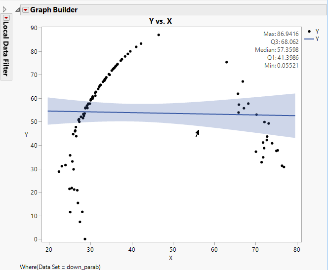

You want to use the same X and Y role assignments for all graphs (assigning the X variable to the X axis, and the Y variable to the Y axis). You also want to change the smoother to a line of fit, and add a caption box with summary statistics to the scatterplot.
You can customize a graph in Graph Builder and then copy the graph as a template and apply it to all of the hover labels in this graph.
Customize Graphs
1. Place your pointer over the blue bar for down_parab and click the graph to open it in a new window.
The graph opens in Graph Builder.
Note: Notice that when you launch a preset graph, you see a Local Data Filter at left. You can use the Local Data Filter to expand and modify the graph. For details, see Local Data Filter.
2. Click the Graph Builder red triangle and select Show Control Panel.
3. Click the Line of Fit element .
4. Click the Caption Box icon .
5. Under Caption Box, change the Summary Statistic to 5 Number Summary.
6. Click Done.
Figure 9.43 Customized Graph for down_parab
7. Click the Graph Builder red triangle menu and select Save Script > To Clipboard.
8. Close this Graph Builder window.
9. In your original graph, right-click and select Hover Label > Paste Graphlet.
This applies the customized graph as a template to all hover label graphs. Hover over a few bars to see the changes.

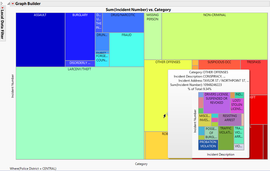

4. Click the Treemap element .
You can see a treemap of the different police districts in San Francisco.

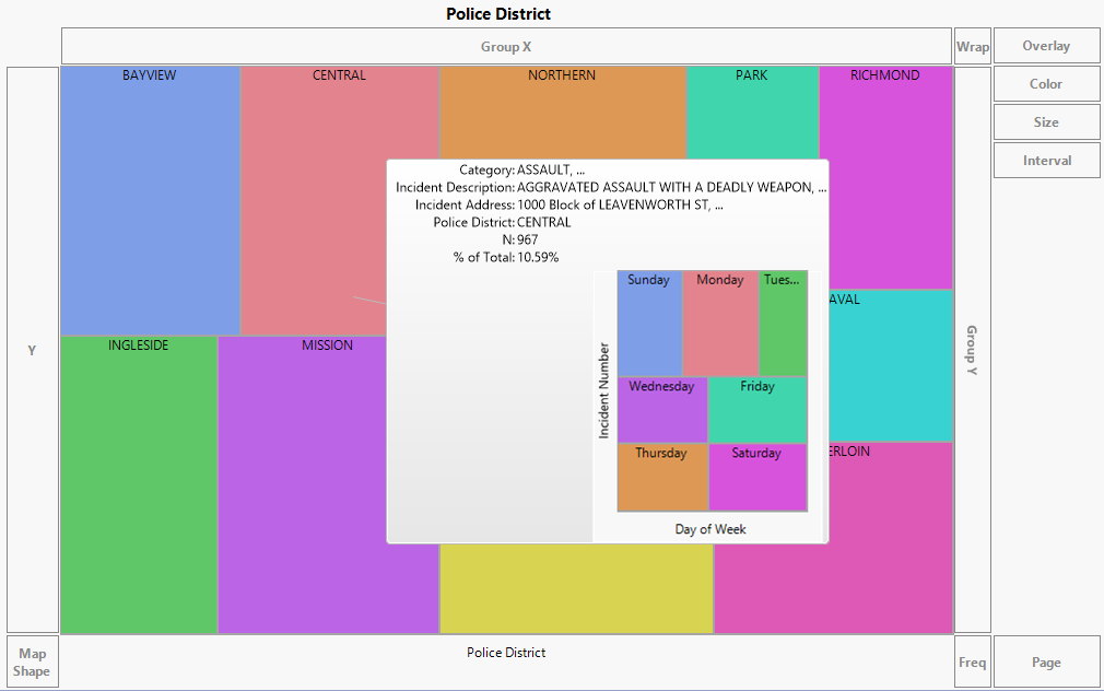

5. Right-click on the graph and select Hover Label > Treemap.
6. Put your pointer over Central to see the hover label graph.
Figure 9.44 Initial Hover Label Graph for Central
The hover label graph is showing the number of incidents in each district by the day of the week. Instead, in this example, you want to see the number of incidents in each district by category.

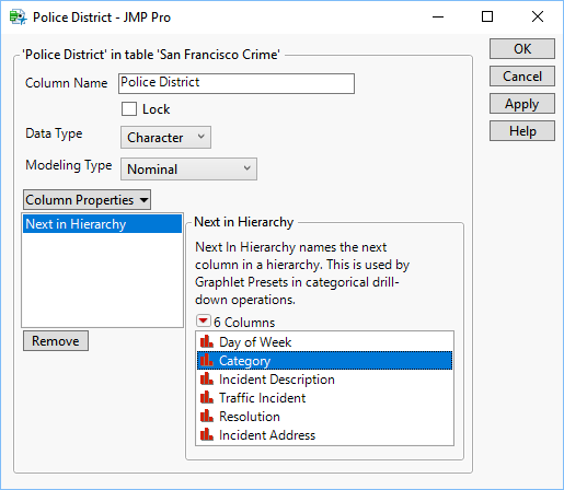

1. In the San Francisco Crime.jmp data table, right-click the Police District column heading and select Column Properties > Next in Hierarchy.
2. Under Next in Hierarchy, click Category.
Figure 9.45 Category Selected for Next in Hierarchy
3. Click OK.

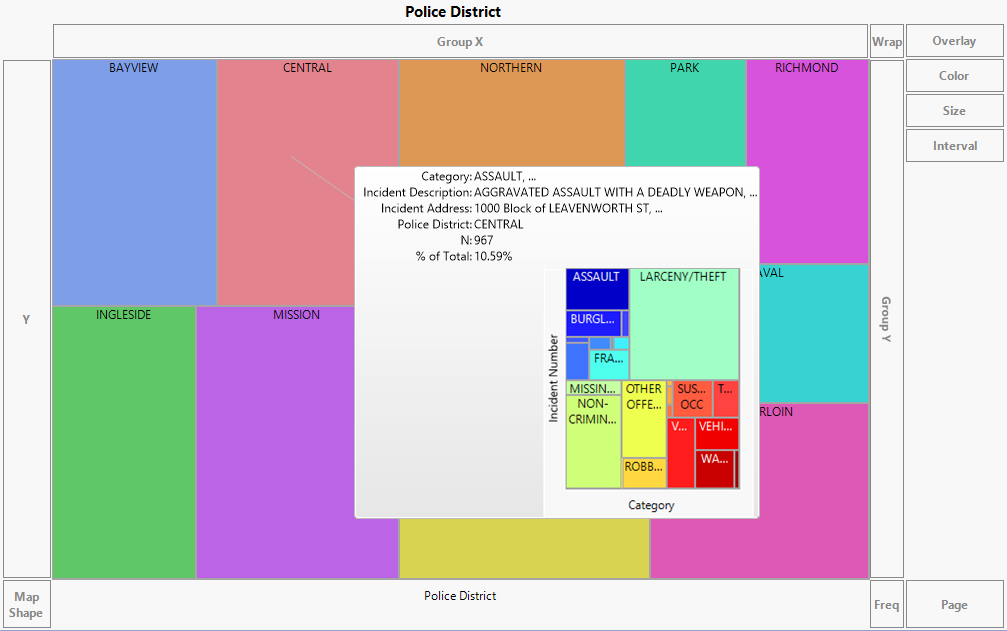

5. In Graph Builder, put your pointer over Central again to see the updated hover label graph.
Figure 9.46 Updated Hover Label Graph for Central
The hover label graph is now showing the number of incidents in each district by category.
6. Click the hover label graph to launch it.
7. Put your pointer over Other Offenses.
Figure 9.47 Second Level Hover Label Graph for Other Offenses Category
The second level of the hover label graph is showing the number of incidents in the Other Offenses category by the incident description.

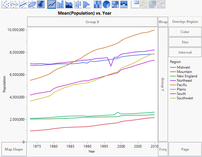

1. Select Help > Sample Data Library and open CrimeData.jmp.
These data show crime rates for regions and states in the U.S.
3. Select Population and drag it to the Y zone.
4. Select Year and drag it to the X zone.
5. Select Region and drag it to the Overlay zone.

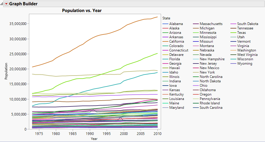

6. Click the Line element .
Figure 9.48 Mean Population Crime Rates by U.S. Region Per Year
This graph shows the mean population in each U.S. region that were impacted by different crime rates over different years. In the hover label graphs, you want to see a more granular view that shows the impacts by U.S state instead of region.

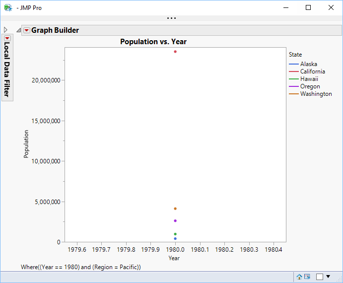

6. In the original graph, right-click and select Hover Label > Paste Graphlet.

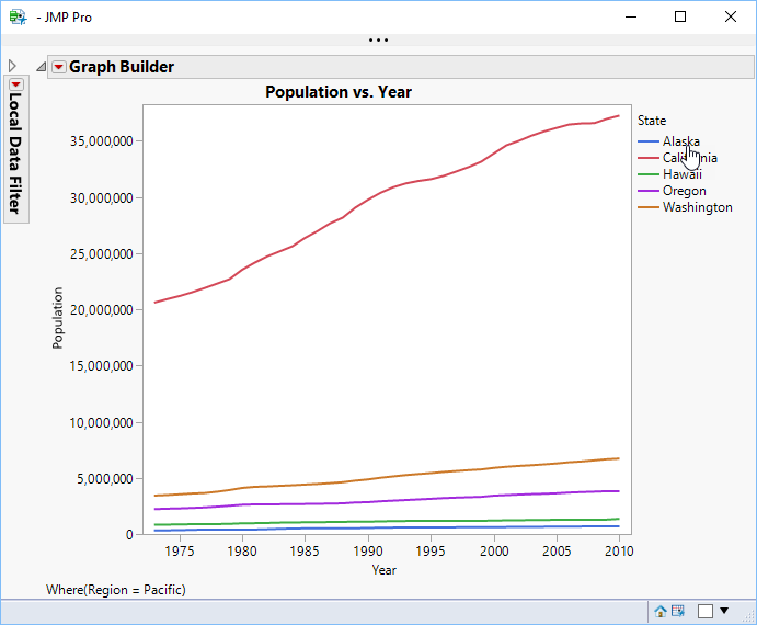

7. Place your pointer over the Pacific line and click to launch the hover label graph.
Figure 9.50 Hover Label Graph Showing Crime Rates by State and Year for the Pacific Region
Because we are still filtering by year, this view is too granular to be useful. You want to remove the year filter, so the graph filters only by region.
8. Close the hover label graph for the Pacific region.
