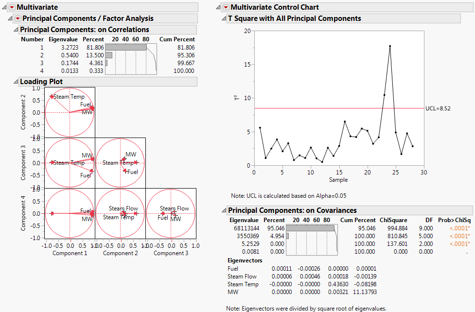

The following example shows how to create an application with parameterized variables. Users select the variables in a launch window, and then predefined reports are generated.
1. Select Help > Sample Data Library and open Quality Control/Steam Turbine Historical.jmp.
2. Run the Principal Component Analysis and Loading plot table scripts to generate the reports.
3. Select File > New > Application.
4. Select Blank Application.
The Application Builder window appears.
5. Enlarge the window.
6. In the Sources pane, drag each Multivariate report onto the application workspace in a single row.
7. Select Edit > Select All.
8. Select Format > Add Container > H List Box to align the reports horizontally.
9. Select each report and type yvar next to Y Variable in the Objects pane.
10. Click the Application red triangle and select Run Application.
11. Select the Fuel, Steam Flow, Steam Temp, and MW variables and then click the Y button.
12. Click OK.
New Multivariate reports appear in one window.
Figure 16.12 Multivariate Application

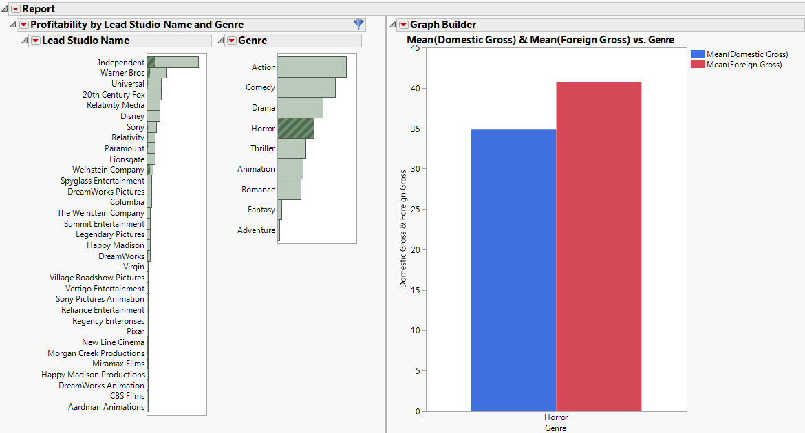

In an application that contains several reports, you can select data in one report and then view only that data in all other reports contained in the same window.
To set up the filter, follow these steps:
1. Create the application and add two reports to the workspace.
2. Select both reports. From the toolbar, select the HListBox icon.
3. Right-click the primary report and select Use as Selection Filter.
This places the primary report display box in a Data Filter Source Box and the parent report display box in a Data Filter Content Box.
4. Click the Application Builder red triangle and select Run Application.
The reports appear in one window (Figure 16.13).
5. Test the application by selecting a histogram bar in the primary report.
Only data for the selected bar appears in the second report.

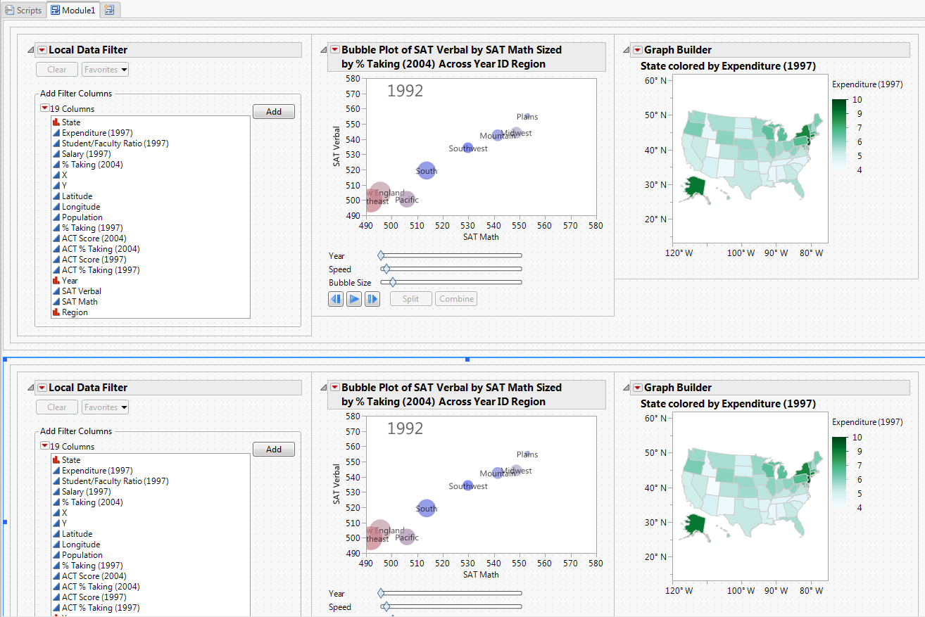

The following example illustrates how to add a Local Data Filter to multiple reports and then filter each report separately.
1. Select Help > Sample Data Library and open SATByYear.jmp.
2. Run these scripts: Bubble Plot by Region and Graph Builder Map.
3. Resize the report windows to make them smaller, so that a 2x2 arrangement will fit on the screen.

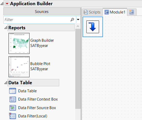

4. Select File > New > Application and choose Blank Application.

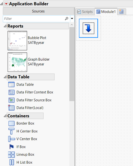

5. Double-click Data Filter Context Box.
This adds a data filter context box to the workspace. Everything placed in this box will share the same Local Data Filter.
Figure 16.14 Adding a Data Filter Context Box
6. Under Containers, drag a H List Box into the Data Filter Context Box.
This allows you to put multiple objects in this box and arrange them horizontally.
Figure 16.15 Adding a H List Box

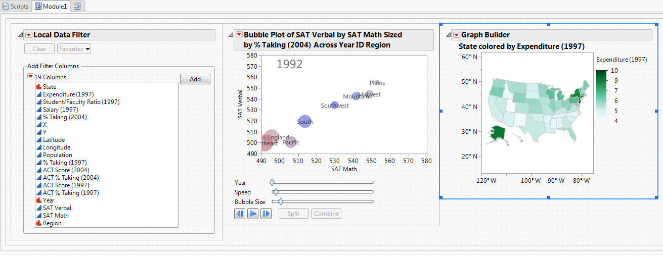

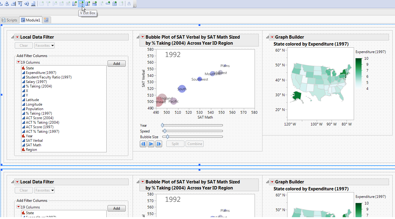

7. Now drag a Data Filter (local), the Bubble Plot, and the Graph Builder report into the H List Box.
Figure 16.16 Adding Local Data Filter and Two Reports
8. Select the entire Data Filter Context Box. Hold down Ctrl and drag it below itself, to place a copy below the original set of reports.
Figure 16.17 Copying Local Data Filter and Reports
9. Select both Data Filter Context boxes, then on the toolbar, click the V List Box icon.
This arranges both reports into a single list box for display purposes.
Figure 16.18 Selecting Both Data Filter Context Boxes and the V List Box Icon
10. Click the Application Builder red triangle and select Run Application.
11. In the Local Data Filter at top, click SAT Math, then click Add. Move the slider to see how it only impacts the reports at top. Do the same for the bottom set of reports.

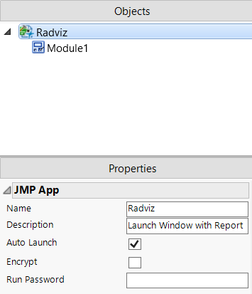

1. In the Objects pane of the blank application, select Application.
2. In the Properties pane:
– Change the Name from Application to “Radviz” and press Enter.
This name appears in the title bar when you run the application.
– Change the Description to “Launch Window with Report”.

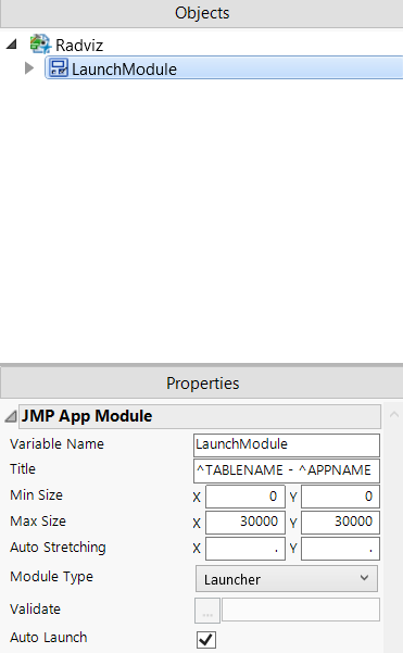

5. In the Objects pane, select Module1.
6. In the Properties pane:
– Change the Variable Name to “LaunchModule” and press Enter.
– Change the Module Type to Launcher.
– Make sure that Auto Launch is selected so that the launch window opens when you run the application.
Figure 16.21 Customizing the LaunchModule

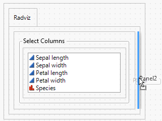

Create the Select Columns Box
1. Drag a Panel Box (under Containers) over the H List Box arrow.
2. In the Properties panel, change the Title to “Select Columns” and press Enter.
3. Drag a Col List Box(All) (under Input) over the Panel Box arrow.
4. In the Properties panel, change the Variable Name to “ColumnList” and press Enter.
The script you add later refers to this variable name.
5. Select DataTable1 in the Objects pane.
The current data table, Iris.jmp, appears in the Path box.

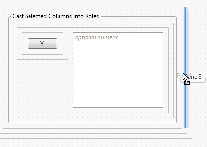

Create the Cast Selected Columns into Roles Box
1. Drag a Panel Box (under Containers) to the right of the existing Panel Box until a blue line appears.
Figure 16.23 Adding the Panel Box
Note: Make sure that you drag the Panel Box to the H List Box shown in Figure 16.23.
2. In the Properties panel, change the Title to Cast Selected Columns into Roles and press Enter.

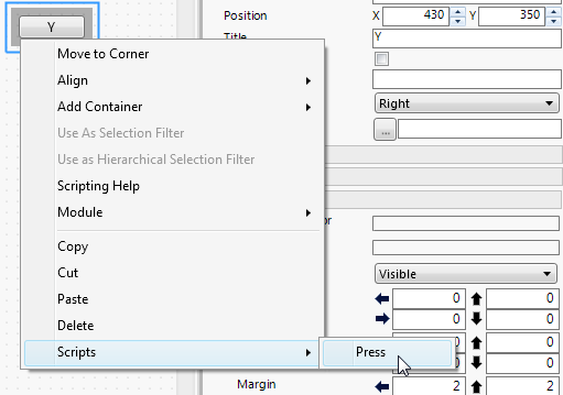

1. Drag a Button Box (under Buttons) over the H List Box arrow.
2. In the Properties panel:
– Change the Title to “Y” and press Enter.
– In the Press box, type “SetY” and press Enter.
You copy and paste the script for this button later.

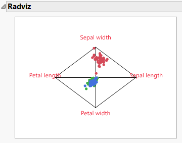

1. In your application window, click the Application Builder red triangle and select Run Application.
2. Select the Sepal length and width and Petal length and width columns, click Y, and then click OK.
A graph of the data should appear.
Figure 16.27 Iris.jmp Graph
If the graph does not appear or errors are generated, make sure that you typed in the correct variable names when necessary. Also make sure that you added the scripts to the Scripts tab for each module.

When you create an application, you write scripts to provide functionality to display boxes. You can right-click a display box and select a script from the Scripts menu.
Figure 16.28 Adding a Script Interactively
Selecting a script from the Scripts menu adds a placeholder script to the Scripts tab for the selected module. For example, the Press script shown in Figure 16.28 adds the following script to the Scripts tab:
Button5Press=Function({this},
	// This function is called when the button is pressed
	name = this << Get Button Name;
Fill in the placeholder script with your own JSL. In the application that you previously created, you named two variables SetY and ColumnList. Rewrite the preceding placeholder script as follows:
