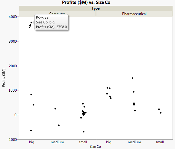

3. Click Profits ($M) and drag and drop it into the Y zone.
4. Click Size Co and drag and drop it into the X zone.
5. Click Type and drag and drop it into the Group X zone.
Figure 5.21 Graph of Company Profits
The graph shows that one big computer company has very large profits. That outlier is stretching the scale of the graph, making it difficult to compare the other data points.
6. Select the outlier, then right-click and select Rows > Row Exclude. The point is removed, and the scale of the graph automatically updates.

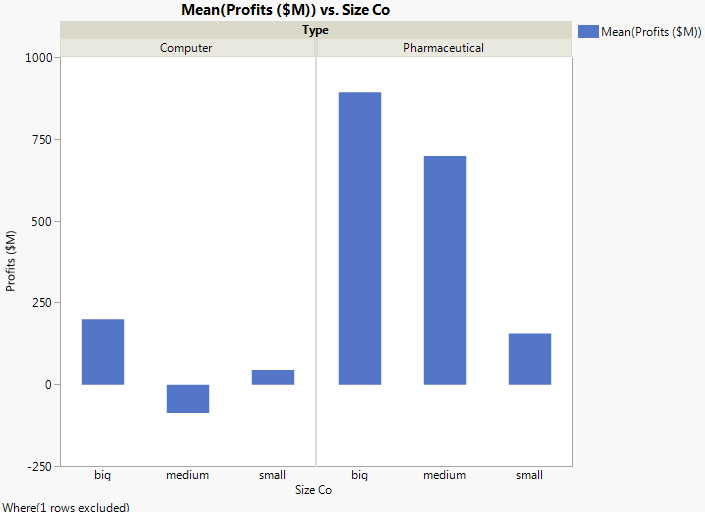

7. Click the Bar icon. Comparing mean profits is easier with bar charts than with points.
Figure 5.22 Graph with Outlier Removed
The updated graph shows that pharmaceutical companies have higher average profits. The graph also shows that profits differ between company sizes for only the pharmaceutical companies. When the effect of one variable (company size) changes for different levels of another variable (company type), this is called an interaction.

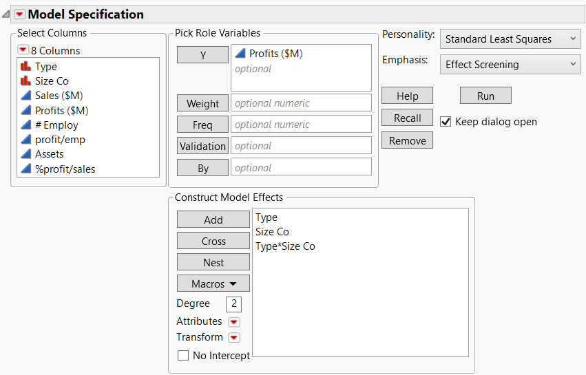

1. Return to the Companies.jmp sample data table that has the data point excluded. See Discover the Relationship.
3. Select Profits ($M) and click Y.
4. Select both Type and Size Co.
5. Click the Macros button and select Full Factorial.
6. From the Emphasis menu, select Effect Screening.
7. Select the Keep dialog open option.
Figure 5.23 Completed Fit Model Window
8. Click Run. The report window shows the model results.

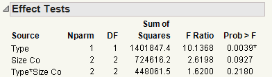

The Effect Tests report (Figure 5.24) shows the results of the statistical tests. There is a test for each of the effects included in the model on the Fit Model window: Type, Size Co, and Type*Size Co.
Figure 5.24 Effect Tests Report
First, look at the test for the interaction in the model: the Type*Size Co effect. Figure 5.22 showed that the pharmaceutical companies appeared to have different profits between company sizes. However, the effect test indicates that there is no interaction between type and size as it relates to profit. The p-value of 0.218 is large (greater than the significance level of 0.05). Therefore, remove that effect from the model, and re-run the model.
