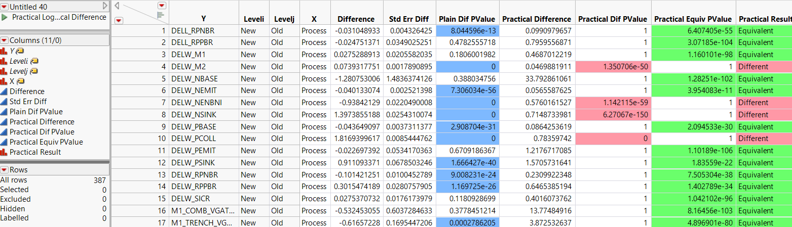

The Compare Means data table provides results for both tests of practical difference and tests of practical equivalence. Each row compares a response across two levels of a categorical factor. Results of the pairwise comparisons are color-coded to facilitate interpretation. See Practical Difference for a description of how the practical difference is specified. See Example of Tests of Practical Significance and Equivalence for an example.
Figure 21.9 Compare Means Data Table
The Compare Means data table contains a script that plots Practical LogWorth by Relative Practical Difference. Relative Practical Difference is defined as the actual difference divided by the practical difference.

Practical Result
A description of the results of the tests for practical difference and equivalence. Values are color-coded to help identify significant results.
– Different (Pink): Indicates that the absolute difference is significantly greater than the practical difference.
– Equivalent (Green): Indicates that the absolute difference is significantly within the practical difference.
– Inconclusive (Gray): Indicates that neither the test for practical difference nor the test for practical equivalence is significant.
